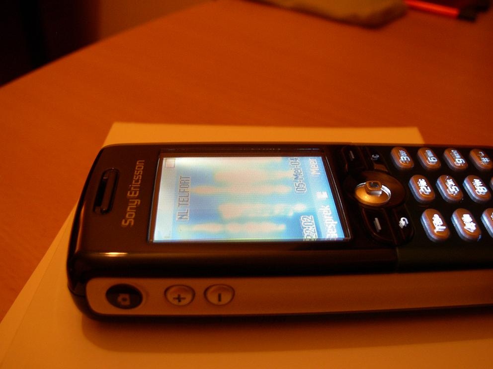

At this moment I'm trying to convert my T610 into a T630.
Now, after a ordered the T630 TFT display. I flashed the T610 to a T630, and it work very fine.
As you can see, the phone is perfectly working with the T630 display and firmware. The T630 display is alot brighter, and you can also see the display good in sunlight and from aside
Our last stage of the project wil be changing the exterior. We order a full T630 housing, but only that will not work on your T610.
You'll need also a T630 keypad (not where you press on, but the one under that.)
When I get my T630 with housing, I'll post it also here to show you all.

Yes, it more easy to buy a T630 and sell your T610.
But this is alot more funny, and I can always convert it back to a T610 if I like

Ginz Posts: 368
Quote:
On 2004-05-06 21:53:15, imanuk wrote:
Can the T610 be upgraded to the T630s firmware without the new screen?
(I'm doubting it can and it prob already been asked but hey sometimes I am to lazy to )
Thanks for the info tho, I think your experiment was worth it just to test the outcome. Thanks.
No, that's not possible.
